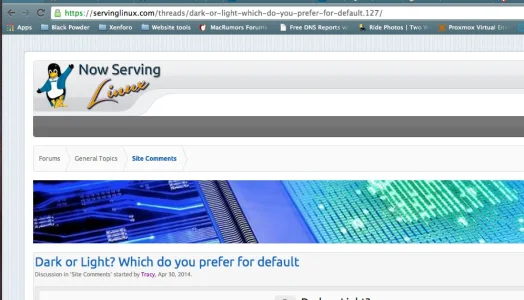

If you are running in a subdirectory then you may need the rewritebase defined.
EDIT:
And that looks like what is the problem because your normal string is
http://sociallyuncensored.eu/forums/forums/general-population.43/

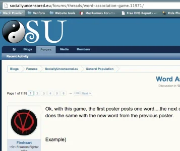

EDIT:
Attachment replaced with another one to prevent a wee-wee match from starting.
Why... it's working like it's supposed to... you are confusing yourself because you have it in a subdirectory called forums apparently. This is what shows when you go into a thread (and it is what should show if you have your forum in a subdirectory called /forums).
I'm aware of that.
