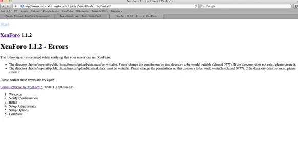

I keep on getting these errors when I 'upload' e.g updated
Then when I go to 'install' your on 1.1.0 update -.- what do I do I followed the info. And Hostgator says 'Richard B.:I'm not sure how your script works so I can't tell you what to do from here. ' and this Richard B.:You may need to contact the script developer as it seems that some files my be missing and this' Richard B.:You can try now but 0777 most likley will not work on our server. '

Do they absolutely have to be 777? Seems like they could be 775 or even 755 if the ownership settings were correct (Apache:web, or something similar)

Yeah, but in the case of the OP, his host may not allow 777 permissions.
This is just an upgrade, so it was obviously working before. It sounds like he merged a few directories and changed their ownership by accident. A quick look inside the directories at the XF-created files (the attachments directory, the attachments themselves, etc) should show what user created those files and what group they're a member of. Then you could chown and chmod the data and internal_data directories accordingly.
I'm just thinking through the problem... I know XF calls for those directories to be world-writable, but the reality is the web server is the only user that's going to be working in them. You're really just making sure that user has access, 777 is the easiest way to do that, but not the only way.

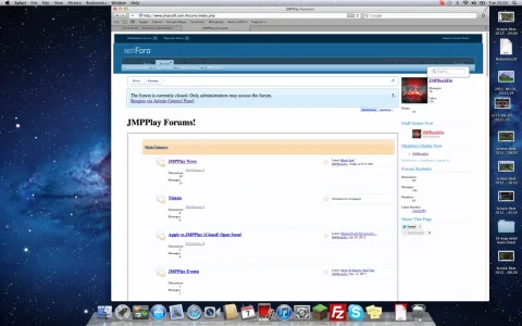

Right now I am getting this.
Looks like I have to pay once again $70pound to updated it Much more better if there had 'updated button'

I'm with Brogan. You need to make friends with someone who can show you how to upload the files. Whatever you've messed up would probably only take a minute to fix. Last time, you put the files in the wrong directory.
I wouldn't recommend an 'update' button as a feature. Wordpress has had one forever, but it's useless for me. A self-updating website depends on a certain level of access and permission that is rarely the same from one host to another.
