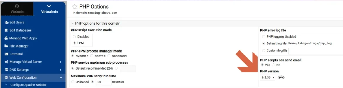

Just updated my forums to 8.3.35 (latest 8.3 version the remi respository was showing) pending updating to 8.3.36 (the patched version). After updating my VPS, I checked and it looks like the remi repository has the update to 8.3.36 and it installed it:
  php83-php-cli-8.3.36-1.el8.remi.x86_64
  php83-php-common-8.3.36-1.el8.remi.x86_64
  php83-php-fpm-8.3.36-1.el8.remi.x86_64
  php83-php-gd-8.3.36-1.el8.remi.x86_64
  php83-php-gmp-8.3.36-1.el8.remi.x86_64
  php83-php-intl-8.3.36-1.el8.remi.x86_64
  php83-php-mbstring-8.3.36-1.el8.remi.x86_64
  php83-php-mysqlnd-8.3.36-1.el8.remi.x86_64
  php83-php-pdo-8.3.36-1.el8.remi.x86_64
  php83-php-pspell-8.3.36-1.el8.remi.x86_64
  php83-php-xml-8.3.36-1.el8.remi.x86_64
I'm using Webmin/Virtualmin for my VPS.
Correct it is now on Remi's repo. How you get it installed matters little. If you're running PHP 8.3 then you need PHP 8.3.36.
