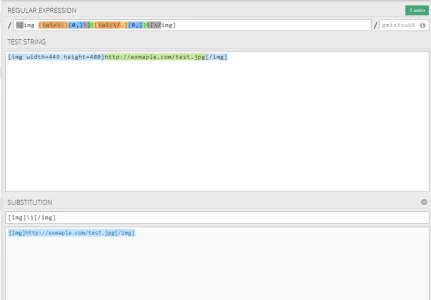

Quick Find:
[img
Regular Expression:
#\[img [\w\=\ ]{0,}\]([\w\:\/.]{0,})\[\/img]#
Replacement String:
[img]\1[/img]
untested off the top of my head, let me know if you have problems
edited my post above to show bbcode instead of embedding it...hope that helps someone answer my question

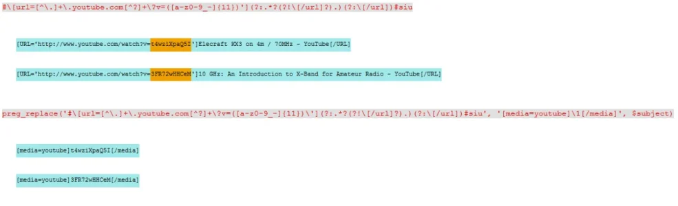

Quick Find:
youtube
Regular expression:
#\[url=[^\.]+\.youtube.com[^?]+\?v=([a-z0-9_-]{11})'](?:.*?(?!\[/url]?).)(?:\[/url])#siu
Replacement String:
[media=youtube]\1[/media]
Quick Find:
youtube
Regular expression:
Replacement String:
Thanks for the quick reply. That worked for the example I posted, but not for any other youtube link. Here's another example that did not convert:
[URL='http://www.youtube.com/watch?v=3FR72wHHCeM']10 GHz: An Introduction to X-Band for Amateur Radio - YouTube[/URL]
This should work as long as there aren't any extra parameters in the youtube URL

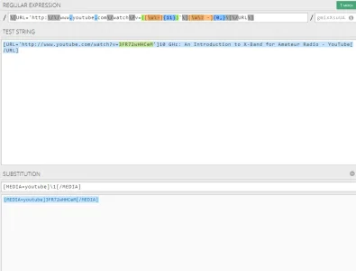

Quick Find:
Regular Expression:
#\[URL='http:\/\/www.youtube.com\/watch\?v=([\w\-]{11})'\][\w\: -]{0,}\[\/URL\]#
Replacement String:
[MEDIA=youtube]\1[/MEDIA]
Quick Find:
Regular Expression:
Replacement String:
Thanks for the help, but that didn't even find the last example I posted :(
I couldn't tell you why it would not apply other than human error on your end...
