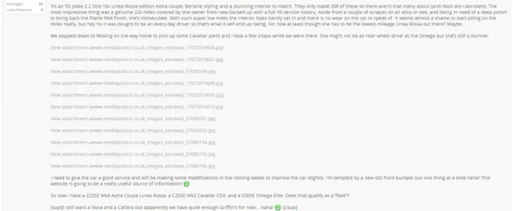

I think something has gone wrong with this now.
From the logs:
2013-09-09 05:57:29 Modified post # 1152304 Changed: http://img.photobucket.com/albums/v318/markmk/art_x788y1024_41056331_1.jpg => [attach=full]30375[/attach]
2013-09-09 05:57:30 Rehosted: http://www.mediajustice.co.uk/images/astrawip/17072010604.jpg For post # 1152420
2013-09-09 05:57:30 Modified post # 1152420 Changed: http://www.mediajustice.co.uk/images/astrawip/17072010604.jpg => [attach=full]30376[/attach]
2013-09-09 05:57:31 Rehosted: http://www.mediajustice.co.uk/images/astrawip/17072010602.jpg For post # 1152420
2013-09-09 05:57:31 Modified post # 1152420 Changed: http://www.mediajustice.co.uk/images/astrawip/17072010602.jpg => [attach=full]30377[/attach]
2013-09-09 05:57:32 Rehosted: http://www.mediajustice.co.uk/images/astrawip/S7000199.jpg For post # 1152420
2013-09-09 05:57:32 Modified post # 1152420 Changed: http://www.mediajustice.co.uk/images/astrawip/S7000199.jpg => [attach=full]30378[/attach]
2013-09-09 05:57:33 Rehosted: http://www.mediajustice.co.uk/images/astrawip/17072010608.jpg For post # 1152420
2013-09-09 05:57:33 Modified post # 1152420 Changed: http://www.mediajustice.co.uk/images/astrawip/17072010608.jpg => [attach=full]30379[/attach]
2013-09-09 05:57:34 Rehosted: http://www.mediajustice.co.uk/images/astrawip/17072010609.jpg For post # 1152420
2013-09-09 05:57:34 Modified post # 1152420 Changed: http://www.mediajustice.co.uk/images/astrawip/17072010609.jpg => [attach=full]30380[/attach]
2013-09-09 05:57:35 Rehosted: http://www.mediajustice.co.uk/images/astrawip/17072010613.jpg For post # 1152420
2013-09-09 05:57:35 Modified post # 1152420 Changed: http://www.mediajustice.co.uk/images/astrawip/17072010613.jpg => [attach=full]30381[/attach]
2013-09-09 05:57:36 Rehosted: http://www.mediajustice.co.uk/images/astrawip/S7000201.jpg For post # 1152420
2013-09-09 05:57:36 Modified post # 1152420 Changed: http://www.mediajustice.co.uk/images/astrawip/S7000201.jpg => [attach=full]30382[/attach]
2013-09-09 05:57:37 Rehosted: http://www.mediajustice.co.uk/images/astrawip/S7000202.jpg For post # 1152420
2013-09-09 05:57:37 Modified post # 1152420 Changed: http://www.mediajustice.co.uk/images/astrawip/S7000202.jpg => [attach=full]30383[/attach]
2013-09-09 05:57:37 Rehosted: http://www.mediajustice.co.uk/images/astrawip/S7000194.jpg For post # 1152420
2013-09-09 05:57:37 Modified post # 1152420 Changed: http://www.mediajustice.co.uk/images/astrawip/S7000194.jpg => [attach=full]30384[/attach]
2013-09-09 05:57:39 Rehosted: http://www.mediajustice.co.uk/images/astrawip/S7000193.jpg For post # 1152420
2013-09-09 05:57:39 Modified post # 1152420 Changed: http://www.mediajustice.co.uk/images/astrawip/S7000193.jpg => [attach=full]30385[/attach]
2013-09-09 05:57:40 Rehosted: http://www.mediajustice.co.uk/images/astrawip/S7000190.jpg For post # 1152420
2013-09-09 05:57:40 Modified post # 1152420 Changed: http://www.mediajustice.co.uk/images/astrawip/S7000190.jpg => [attach=full]30386[/attach]
2013-09-09 05:57:41 Rehosted: http://www.mediajustice.co.uk/images/cavwip/injector-report-x30xe.jpg For post # 1152597
However, the add-on is inserting the images back into the posts as links??
http://www.z22se.co.uk/threads/greetings-to-all.16805/#post-1152420
It looks like it's not picking the URLs up as images, but as generic attachments

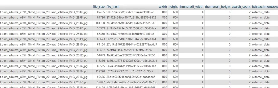

So, looking in the database, the images don't have thumbnail dimensions
I've manually added the dimensions to two of the images, which has fixed those. I might try doing a thumbnail rebuild against the whole attachment system when it's finished to re-populate them.

That does sound like a temporary problem with the ImageMagick upgrade breaking the link with Apache, and the XF attachment system. Basically XF calls IM (or GD) to determine if the attachment is an image (and later to get a thumbnail). If IM is failing, then XF will assume it's not an image, and just insert it as an attachment.
It's possible that the XF thumbnail rebuild will not work if it skips attachments with (0,0) thumbnails size. A solution might be to set the thumbnails to something like 80x80 manually with SQL. Then run the rebuild.

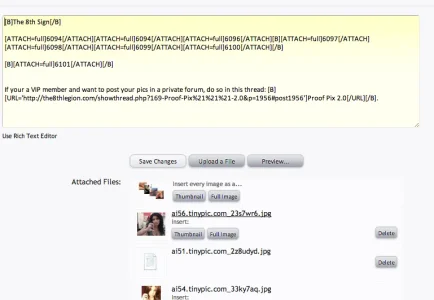

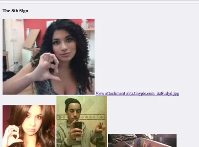

I have an error where an attachment that used to work now only shows a link in the post and when editing the post, it does not show a thumbnail to the attachment, although the attachment works when I click the link. Is this related to after rebuilding thumbnails with keep original name in BD Attachment Store @MattW or is this a MetaMirror issue?
The attachment: http://data.8thos.com/data/attachment-files/2010/09/9861_ai51.tinypic.com_2z8udyd.jpg
Screenshots:
That looks similar to the issue MattW was having, if the thumbnail generation fails, then the XF attachment system assumes it is not an image. The only thing I can think of there is to re-run rebuilding thumbnails. :(
I don't THINK it's a MetaMirror issue, just showing up here because of the very large number of thumbnails being generate perhaps stresses the system. And if if that attachment worked before, them MM will not touch the attachment again, so it's something else (failing during rebuild)
