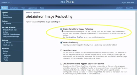

Okay so I tested it out per directions and everything is good so far thanks to @MattW help. Only question I have is how do I turn this on? All I did was run the cron. Is that all I needed to do?
Aha, I need to clarify that. You just go into the MetaMirror Image Rehosting Options, and check "Enable MetaMirror Image Rehosting".
I've updated the instructions:

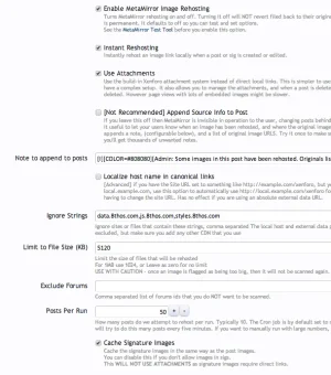

I've got my metamirror set to run 50 posts in AdminCP/Options
What are yours set to?
Mine was set to ten.

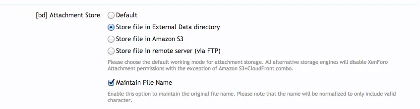

Might be incompatible with Attachment Store. What do you have Attachment Store configured to do?
More likely might just be because you were running the testing tool while MetaMirror was enabled, so it was running simultaneously with the cron job.
Yes. I did run the testing tool while MetaMirror was enabled. @MattW configured everything for me earlier. About 6 hours later I decided to test out metamirror and forgot that it was already enabled. But the fact that there are only 32 pictures in the data/MetaMirrorCache folder after 6 hours means it wasn't running at all. I'm wondering if the tests I ran is what caused images to go in there in the first place.
