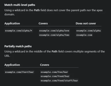

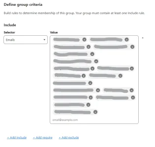

I agree, there is something letting access through. I have only a single rule for this subdomain, and I'm not seeing why it won't work using a "clean" browser and a VPN (to rule out anything stored in a browser).I'd say it's fairly safe to say that your Zero Trust Access rule is either not matching the request, or you have a different rule taking priority that is letting it through.
Yeah, that's what I'm thinking also.Well, what I would do is simplify everything and slowly add individual things until you fnid the culprit. Like start with blocking test.yourdomain.com/zero-trust-test for everyone. Check if that works as intended, if it does add one more thing... like allowing one user to access it. Check that... etc, etc...
You will find which exact part is causing an issue as you add one thing at a time.
I realized that I had to set the test subdomain to "Proxy" rather than "DNS only" in DNS settings. I changed the setting yesterday and now it seems to be working.You will find which exact part is causing an issue as you add one thing at a time.
