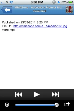

I thought id try out the podcasts. The screenshots below are using 'Podcaster' on my iphone4.
The decided to use an mp3 for testing.
I added both the podcast and RSS directory, and they both point to an image but not the the podcast
http://mmazone.com.au/community/media/category/workouts.14/podcast
http://mmazone.com.au/community/media/category/workouts.14/rss
First screenshot shows the info, this happens when i add either the rss or podcast URL, it doesnt matter which I add, they both import fine but they dont play.

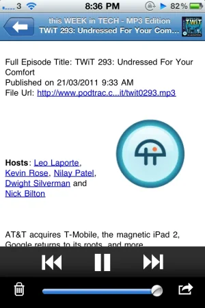

This is a screenshot of a popular podcast, as you can see it points to an mp3. I dont think my podcast should be pointing to a jpg image?

EDIT: thought maybe it wasnt working because i added it to a category that already had a youtube video. So I tried in a category that was empty, I added the MP3 and now i actually get an error 'Download failed. bad URL and then it points to a jpeg. Ive moved the mp3 back to the original directory above incase you wanted to test.
Hmm... go into EWRmedio_Model_Sitemaps and replace on line 110:
if (!$local && $media['service_feed'] == 'null')
With:
if ($local && $media['service_feed'] == 'null')
Then try again.
With:
Then try again.
Hi Jaxel,
I made the edit on the php file and added the podcast again, still showing the image instead of the mp3. So I deleted the mp3 and added it again, tried again but still same issue. /podcast adds the 1 mp3, /rss adds both mp3 and the one video in that category, both ways still shows image. I deleted the mp3 and added it to its own category 'podcast' tried again but still shows an image.
