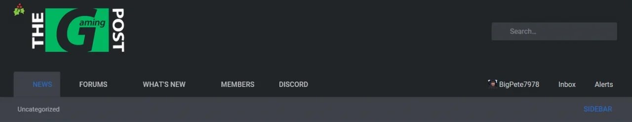

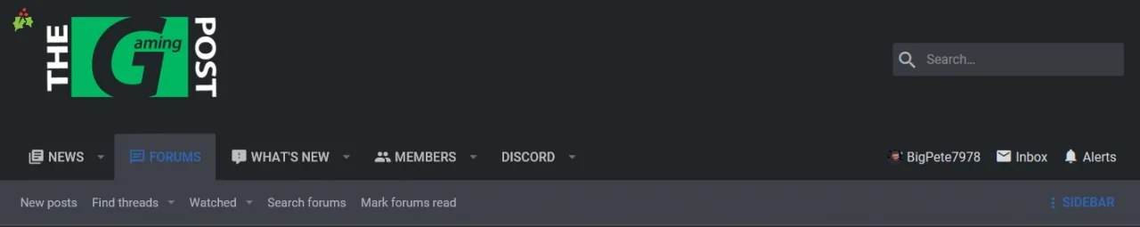

The two images below are the top: Wordpress Header and bottom: XenForo Header. The icons aren't transferring over for some reason, and I cannot figure out why at all.

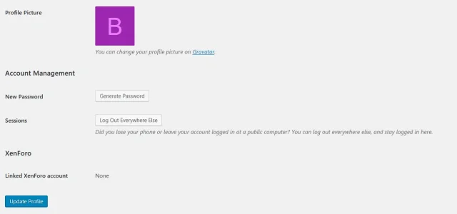

Also for some reason my XenForo account isn't linking to my "Wordpress Account". Same email and everything, but nothing is connecting the two. Is there something I am missing here?
Yes I do have SSO enabled.

Go ahead and create a ticket so that one of our staff can help you further on this header issueNow I am confused. They just linked and I literally did nothing. I enabled SSO over an hour ago when I installed the add on, yet it just now linked them. Is there a delay of sorts with the SSO?
So it looks like the only issue now is the header issue.
