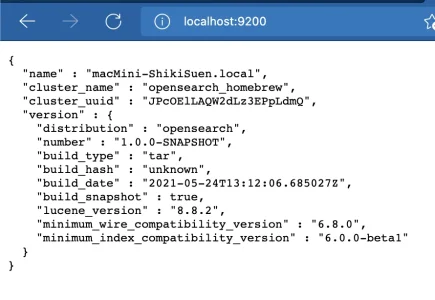

Closed XFES cannot distinguish version number between ElasticSearch and OpenSearch.
ShikiSuen
Affected version
2.2.1
This issue hindered me from using XFES with OpenSearch on my mac mini. (I installed OpenSearch with homebrew.)

This and similar issues are tracked in https://github.com/opensearch-project/OpenSearch/issues/693. Please take a look and comment on https://github.com/opensearch-project/OpenSearch/pull/814 that attempts at resolving it. Generally, we are doing our best to keep OpenSearch 1.0 backwards compatible with ES 7.10.2, see https://opensearch.org/faq/#c3. If you find any issue like this one where a xfes does not work against OpenSearch 1.0, please take the time to report it and we'll do our best to fix!
Moving past 1.0, XFES can check the "distribution" field in this response and do OpenSearch-compatible version checks if it wants to.

Does this indicate that it actually supports OpenSearch 1.0.0-SNAPSHOT like supporting ElasticSearch 6.x despite the version number incompatibility?
At this moment in time, yes, it is just the version number issue as far as we know.

I would double check that XFES is not doing something based on that version number - in other plugins we see checks that say "if version is <= 6 do X, otherwise if version <= 7 do Y", so 1.0 becomes 6 and that's not good cause it's compatible with 7.
I know a couple of my XF add-ons do that. Part of the reason is ElasticSearch is a something of a compatibility mess if you want to support 2.x - 7.x.
Thankfully they've gotten a lot better about breaking backwards compatibility changes in point release updates, but they still don't have the best track record.
It extracts the major version component and compares it with 2. 1.0.0-SNAPSHOT has major version 1, which is less than 2, so the check fails.
