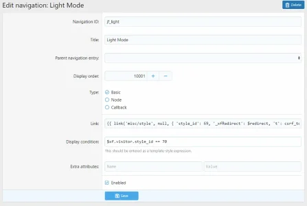

XF 2.2 $xf.visitor.style_id == X does not show for guests
Solution
Better to use $xf.style.style_id, which will give you the ID of the current style. Using $xf.visitor.style_id only gives you the preference, which for the vast majority of users (and all guests) will be 0 (which means to use the default style).

I have two navigation links. This is one of them for "Light mode":
So I want this navigation tab to show for both guests and members if they are on the dark style (style ID: 70) and visa versa.
