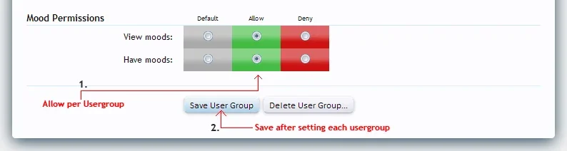

First, log into your AdminCP and go to >> User >> Usergroups and select the usergroups you want to allow to view, use and/or both. Normally you've correctly set everything just forgotten to allow the appropriate permission per usergroup.
Scroll down to the bottom upon selecting the usergroup and set accordingly (Screenshot Below)

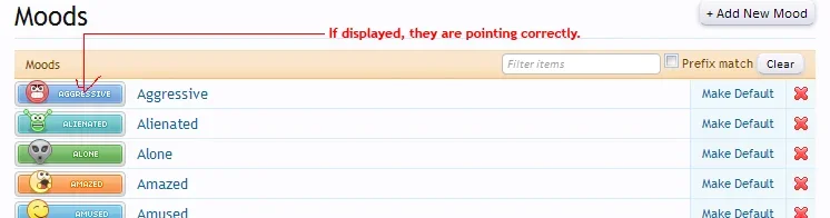

A quick way of telling that you've set the moods correctly is by venturing into the AdminCP and under Options you see Moods which you can click and if they are listing correctly and showing it'll be permission based issues (Revert to above).

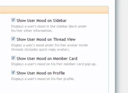

You may also want to check whilst in the AdminCP and go to Appearance >> Style Properties scroll down and click on Moods ensuring that the boxes are all checked, or at least, the areas you want the moods showing in so adjust accordingly. (Screenshot Below)
