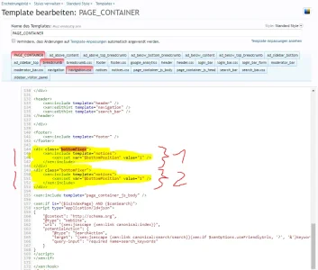

If you look closely, it’s actually closing it. It seems your template has two instances of the “bottomFixer” div which is what the notices are rendered into.
Oh... Chris I love you. :D
But how is this going on?
Iam absolutly sure that I not have touched this template the last months.
Can one reason be that I have installad beta 1 and beta 2 bevor stable?:unsure:

I experienced the same thing after upgrading to 1.5.21, removing the extra bottomFixer div resolved it. Couldn't see it in chome, but could tell that it was loading two instances in MS-Edge.
However, i went ahead and reverted my page_container template and manually re-inserted my custom changes. It hadn't been done in a while, and resulted in a cleaner template.
