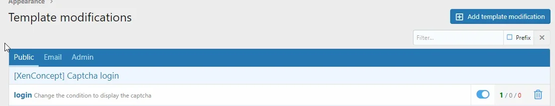

Verified that the template modification was not applied twice

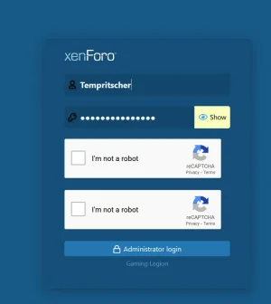

addon is active now. here is the link: https://www.gaming-legion.net/admin.php
atm i dont need to change something in the acp.
Hm, I noticed while it works for the admin cp, it doesn't appear for normal logins, would that be possible?
