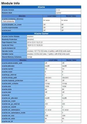

A screenshot of the XCache admin panel is attached.

That is what I figured. I was hoping the problem might ring a bell with someone here. The host tells me XCache is enabled(see the screenshot).

The attached screenshot says nothing about how much memory you actually use from whatever is configured. it should look like this:
http://i1-scripts.softpedia-static.com/screenshots/XCache_1.png
Copy-paste your php.ini and the xCache relevant section.

That page on my XCache panel has no data, just the headings.

If there is no data as I showed, it means that xcache is not installed correctly on the server. Refer to your host to reinstall xcache. And no it doesn't matter how you write xcache in config.pho
