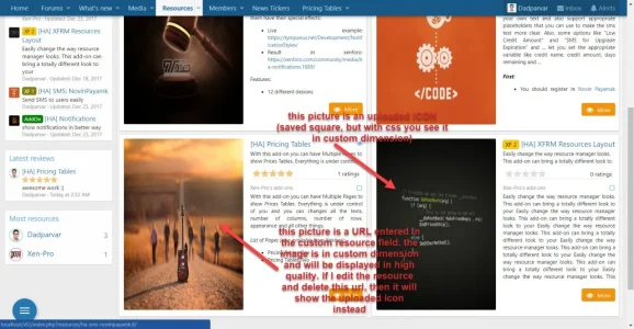

As per the paid request of @ChrisTERiS , a new layout is coming. Will be released when he confirms everything after the tests.
2 screenshots may give you some idea of what the new (second) layout will be.
Suitable for movie or music or similar websites.

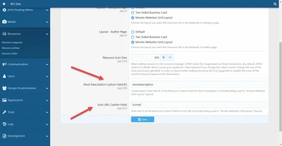

Dadparvar updated [HA] XFRM Resources Layouts (XF2) with a new update entry:
New Layout + improvement!
Added:
  • A new layout: Movies Website Grid Layout (for a better result, you may need to add 2 custom fields - this is added as a paid request by a customer, but current customers can also have it freely, but customizations should be done by yourself)
  • 3 new options for the new layout
