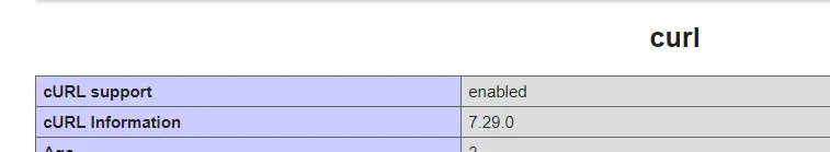

I have curl on my server, BC Math and allow_url_fopen open.
Any ideas what could be wrong?

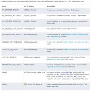

EDIT: These are the errors that can be returned from MaxMind. You are getting the last one...

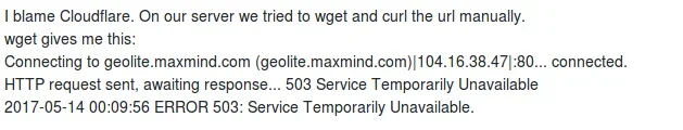

I also did some quick research on false 503 errors and the only other reference I was able to find had to do with nGINX servers having a problem with nginx-ingress. Again, that's not related to this add-on but with the server (whether yours or MaxMind's) and there's nothing I can do about that either.
EDIT 2: I also found references to sites using CloudFlare having a problem connecting to MaxMind. And again, that is a problem with your server, not the add-on.
