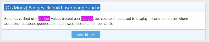

You must perform a user badge cache rebuild if you want to apply changes to already awarded badges.

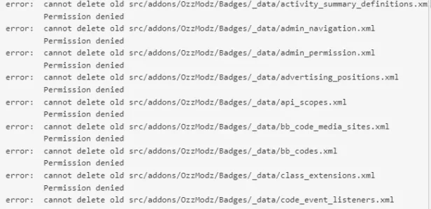

Can't overwrite old files, do you know why?
It's a system administration issue. Make sure the files are owned by the correct user on the system and have the correct permissions.

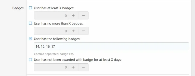

We've noticed that the badge user promotion criteria does not appear to work as expected. We set ownership of 4 badges by unique ID in a comma separated list to trigger a user promotion, and those promotions never occur with the user group promotions cron job run.
Just to be sure, this is the way we're supposed to be setting those criteria, correct?
EDIT: It might not be specific to this addon. We also noted a standard user group promotion based on default criteria also works unreliably. Trying to pinpoint what the precise issue might be but it is proving to be a challenge as there's no discernible difference between two users that should get a promotion, and only one of them actually gets it...
Sent you the latest version in PM for testing. This criteria has been optimized and changed to a drop down list.

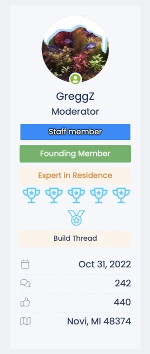

Hi so I set up a new badge to award a trophy. It awarded a lot more than 1 as you can see here:
Screenshot 2022-12-16 at 3.50.46 PM.webp Any idea why 5 trophies are showing up instead of just the one?
I did at the beginning but then turned it off once I saw this. Then ran the cron but didn’t remove. Should I delete and start again?
If you rebuild badges I think it may fix it? I do not know if they will be removed or not if you do that.
