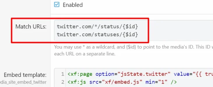

It looks like Twitter (now X), is having new post come from X.com instead of Twitter.com, this is now breaking auto embeds. Anyone have a fix, or so we have to wait for an Xenforo update?

You should be able to (if it is THAT important to you) be able to fix it yourself immediately (for how Twitter-Pater is working right now, give Musk a week or so and he'll change it again).
Go to
ACP -> Content -> BB Code Media Sites
Choose your Twitter media site
In match URL's add x.com/*/status/{$id} x.com/*/statuses/{$id}
as shown in the link provided above to Brogans solution... you should be able to cut/paste those links to add into your URL match instead of having to type it in.

You may have to go into developer mode by editing your config.php.
