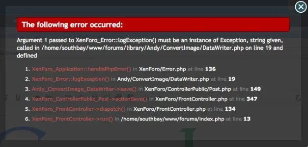

Thank you for sharing. But it looks like this also requires debug mode to be enabled.
The reason for my request is to allow admins to easily see what error is causing my add-on to not function. The Server Error Log is ideal for this assuming I don't want to throw up an error in the front end. Unfortunately this doesn't appear possible unless debug mode is enabled.

XenForo_Error::logException its didn't require debug mode. :D
