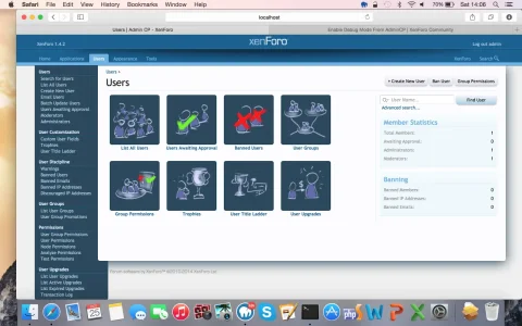

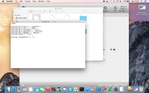

Trying to get an XenForo localhost server running on the Mac I bought yesterday, completely new to them BTW. Here's the issue. Debug mode is enabled, but I don't see the Development tab in the Admin control panel. This worked on my other installations. Using MAMP for web server if that's of relevance.

Screen Shot 2014-10-25 at 14.06.07.webp Screen Shot 2014-10-25 at 14.06.33.webp
Make sure that config.php file is the file used by XenForo. Try changing the database and reload the page to see if you get an error.

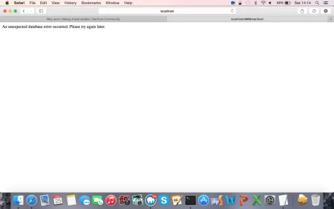

@Brogan Tried, but it's still showing unexpected database error from when I tried changing the database name, but it's changed back to normal now. Could MAMP have a delay in processing this?
Not unless there is some sort of caching involved.
Changes to config.php should apply instantly.
