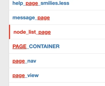

Why are some templates like "PAGE_CONTAINER" in all caps in upper case while others are not?
I'm getting a 403 when editing any template that has a name that's all caps. I tried editing the DB directly but that had no effect so I'm going to have to dive into why only a very small subset of templates give 403s.
First order of business is figuring out what's different about the caps vs all the other templates.
Templates with capitalized names are the final page (container) templates, eg. those that open and close <html>
All other templates are just parts used somewhere within the container.

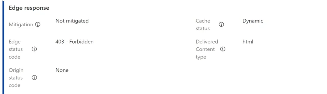

Found my 403 in CF and says "not mitigated" as well so I think that rules out CF.
Nope, the oppositie is true:
Your screenshot pretty much proves that the source is CF as the origin status code is none, eg. the request never reached the origin server.

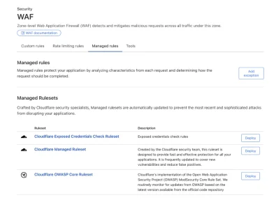

Check the CF managed WAF rules.
