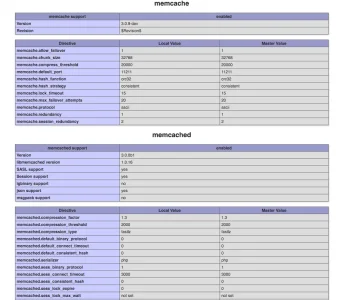

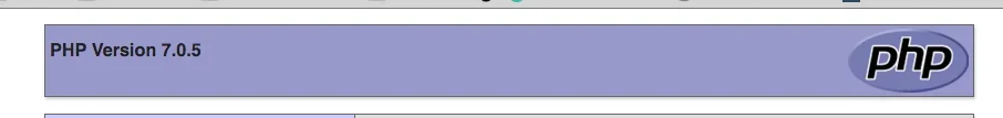

Actually not fully correct. :)
Of course, it does require manual compilation (which is easy enough if using CentOS and CentMin Mod by @eva2000)
