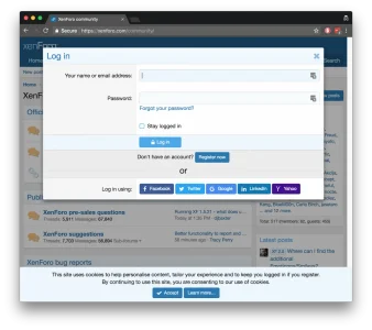

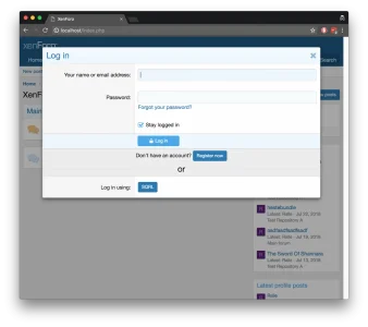

Now, when I go here, I see the SQRL button:

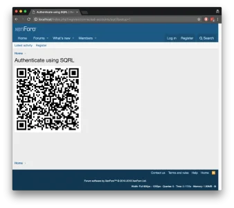

If you look at the method named 'handleAuthorization' in the class before, you see I am overriding the existing OAuth behavior of the parent class to make it present a template with a SQRL QR code. The template 'sqrl_view_qr_code' has the following contents:
HTML:
<xf:title>{{ phrase('authenticate_using_sqrl') }}</xf:title>
<a href="{$sqrlUrl}"><img src="{$dataUrl}" /></a>
HTML:
