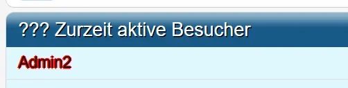

When upgrading from XF 2.1.x to XF 2.2.x, all Unicode characters in (widget) titels are converted to question marks.
Example.
The widget title: 🃏 New posts... becomes: ? New posts... and so on.
It would be nice if we didn't have to manually adjust all Unicode characters in titles during the final upgrade.

Yes, I have a backup of XF 2.1. (Default-Style and some changes in "extra.less") restored and then upgraded to XF2.2 Beta4 from there.
The result stays the same. All Unicodes in titles are shown as question marks.

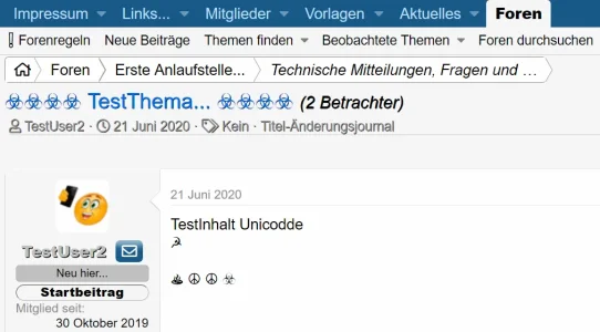

ooh. i read it as thread title. and i added an emoji to a test thread before upgrade. that emoji survived the update from 2.1.10 to 2.2b4. too late to test with widget titles.
Hmm ... does this really only affect titles?
Did you check posts containing utf8 characters with more than 2 bytes (eg. emojis), are they okay?
If not: https://xenforo.com/community/threads/public-service-announcement-check-your-mysql-backup.152740/
Have a look...

Only Unicodes in Widgettitles are shown as question marks.
Also i have run the conversionscript for testing but: "No convertable tables found. No action required."
All tables in the XF database are utf8mb4.
When creating a backup and then restoring, all unicodes are as they should be.
Question marks only appear when upgrading to 2.2.BetaX
