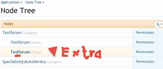

Hi
When I select option "Create New Forum" I getting two forum all the time, same name.
Whay? I only want one forum. Now I need to delete the extre copy forum.

When I put this $config['enableListeners'] = false; in my config file my forum dont make copy.
Then it is an issue with one of your add-ons.
Remove that line from your config.php file and then disable your add-ons one by one in the admin control panel to find the culprit.
Ok, that tells us an addon is causing it.
You need to remove that line, and then disable each addon, one by one and see if it still does it.
When it doesn't do it anymore, the addon that you just disabled is causing the issue, and you should take it to the addon thread :)
