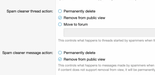

Yes it restores content as well as user, but only if you have the spam cleaner in options set to soft delete (default)
If you set to permantly delete threads and messages then that's it. Gone.

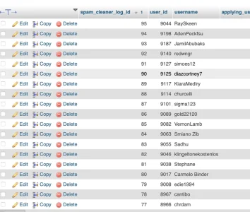

At least you you can either see them all in the spam cleaner log or in the database table xf_spam_cleaner_log
