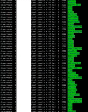

I have some weird folders in the js directory.
ls shows tihis:

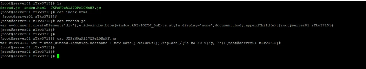

contents of all have 3 files in. Always two js files and one empty html file. Names of the two js files always differ with one of them seemily random.
I found this because an rsync job I have to back up complained that one of the folders had vanished. I thought the name looked odd so too a look and found this.
All in all, there are 2298 folders in my js director! What gives?????

Considering a lot of these are js fils with a hint to "advert" it must be something weird with adverts......

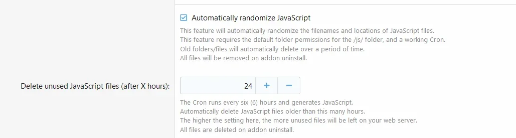

I remember what it is -
It's the Adblock detector I have installed.
[Wutime] AdBlock Detection [anti-AdBlock]​
I was scratching the back of my brain because I knew I had this issue before. I guess my backup/restore process brought in files the addon did not know about and thereor did not delete. :)
No compromise :D
