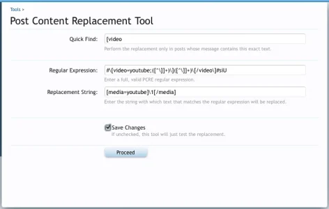

Use Kier's addon: http://xenforo.com/community/threads/post-content-find-replace.6548/ Here is the code you need to use with this addon: Quick Find: [video Regular Expression: #\[video=youtube;([^\]]+)\]([^\[]+)\[/video\]#siU Replacement String: [media=youtube]\1[/media] Here is a picture:

Jake Bunce said: Here is the code you need to use with this addon: Click to expand... Thanks, Jake! I tried that. When the "Save Changes" box is unchecked everything looks fine. I get 914 results that match. But when I check the box and proceed I get the error: "Please enter a message with no more than 5 pieces of media."
P Paul B XenForo moderator Staff member Dec 5, 2011 #4 In which case you need to increase the maximum number of media embeds in Options -> Messages. Upvote 0 Downvote

This is old but saved me a bunch of time! I didn't see this when I was using XF1 now I am on XF2 and thought I was out of luck but thankfully @Chris D Made it availible for XF2 https://xenforo.com/community/resources/categories/xenforo-2.42/ Thanks @Jake Bunce for posting this fix!
