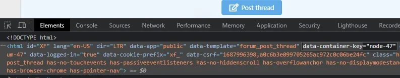

For the page you want to change the wording on, use the browser console to check the template name and data container key ID.
This forum for example is forum_post_thread and node-47.
