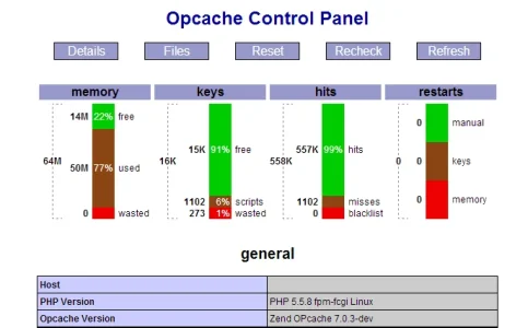

To help you decide...
Meeasly 64MB for opcache and still got 14MB left!
It's a small site though.
[Edit]
Remove host in attachment
