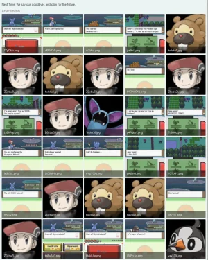

We've been moving a lot of user generated images over to attachment files, and one of the things we've run into occasionally is if those attachment files get unlisted from the post (user copies and pastes an out of date version of their post from an external document, or they the post history is reverted), those attachments wind up with no reference to the post and they all get dumped at the bottom of the post like this:
In some cases these folks may have hundreds of duplicated images in a single post, just chilling at the bottom of their post in an "attachments" section. It becomes impossible to manage.
Do these unreferenced attachments get cleaned up over time, or do they just sit there for eternity? Need to know if we have to go through manual effort to find and remove these or not.
