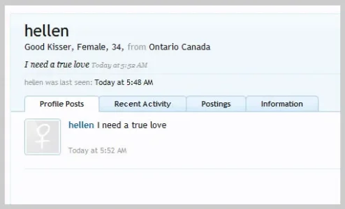

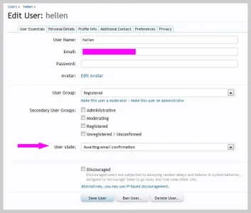

I have a user which signed-up today and also posted a "profile message" onto his own profile and also entered his "locaton" and his "occupation".
The strange thing is:
this user still did not confirm his e-mail-address. When I go into my ACP, then it says for this user:
User state: "awaiting e-mail confirmation"

why and how can a user enter a profile-message onto his profile-page when he even did not confirm his e-mail-address ???

admin.php?user-groups/system-unregistered-unconfirmed.1/edit
profile settings > can post profile post : is this set to inherit, yes, no ?

no idea, but a user has done so on my forum.
the user has posted onto his own Profile-page.
Indeed that would be the spot. :)
the strange thing I see in my left screenshot is the time:
- the post was made at 5:52 A.M
- user was last seen at 5:48 A.M
not sure if the issue is coming from there, but the timing looks a bit strange....?
Ajax actions (like posting statuses) don't update the session activity. They clicked onto the page to post the status at 5:48, and clicked post 4 minutes later without leaving that page.
