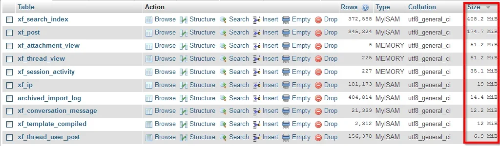

Some of my tables aren't super huge, but also not tiny:

So, if I'm understanding correctly, server loads wouldn't have anything to do with being on MyISAM, right? It seems InnoDB would be better if I'm seeing a ton of locks from a lot of users on at the same time? If that's the case, I'm inclined to want to stick with MyISAM unless I start to see lock problems (no idea how those manifest themselves as symptoms) or find out that InnoDB would really reduce my loads.
