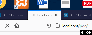

As you can see from the GIF below, I recorded the first 5 seconds of the transaction and it still keeps running and times out after about 3-4 minutes.
![waiting.gif waiting.gif](https://xenforo.com/community/data/attachments/244/244612-9d89c9c607c73abd848254e0d8ad7ed6.jpg?hash=nYnJxgfHOr)
