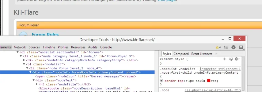

Try a more explicit definition like
.nodeList .nodeList .node:first-child .nodeInfo.primaryContent {
boder: yourcode
It is always difficult to tell without being able to see the example the screenshot is taken of. In general, when using chrome or firefox you can see what classes your element has. As you want to add the border only to your first node, you'll definitly need the .node:first-child in your definition, the rest is a matter of the most explicit definition. You can however try to add the !important-attribute to your code, to ignore every more explicit setting.

Or are you trying to modify the subforum-list? In that case it would be
.forum_view .nodeList .node:first-child {
border: yourborder

Yeap, have seen that and the code above worked for me to get a border right where I needed it. In general, follow these steps to get the element you need:
1. Go to where your subject of change is
2. Right click it in Chrome or Firefox and click "Inspect Element"
3. In the following code window, search for the outest div containing your subject of change. In your case, this would probably be the .nodeInfo-div.
You need to select the same elements like when you alter every single element of the list but add the pseudo-selector :first-child to it. When I apply the code above to your forum, it works fine. As stated above, try adding the !important after your color.

I don't need border-right, though. I need border-top.
I edited my picture to show where the border would be. It's shown in red:
