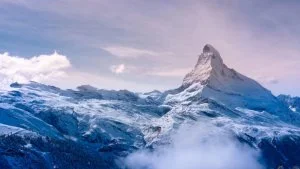

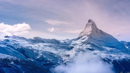

I think theoretically you're correct but after some amount of testing I've been unable to detect a discernible difference, at least not one that is particularly compelling to act upon, so do you have a demonstrable example of the poorer results with the current approach?
In my testing I started with a 3840 x 2160 image and resized it to 1280px wide.
This produced mountain_small.jpg:
I resized that to 300px wide get mountain_thumb_a.jpg:
I then resized the original 4K image again to 300px to get mountain_thumb_b.jpg:
There is no discernible difference in this test and certainly not one that justifies the type of refactor you're implying is necessary here.
