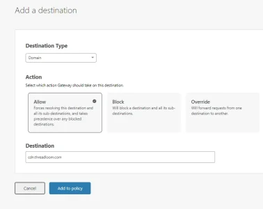

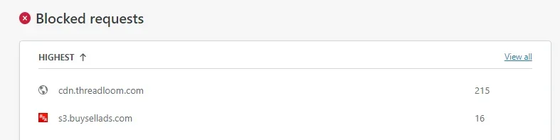

but would that even prevent threadloom from disabling the addon ? are broken cdn.threadloom.com links capable of preventing threadloom from being disabled as an addon in xf 2.1 admin ? Evem with your cdn domain whitelisted, I am unable to disable threadloom addon.
I found the cause of the broken links. I am using Cloudflare Gateway For Team's DNS servers with for my VPN and it seems Cloudflare Gateway blocked your cdn link and incorrectly classified it as spam ! Will report the false classification to Cloudflare Gateway team :)
I'll specifically whitelist it in Cloudflare Gateway for now
