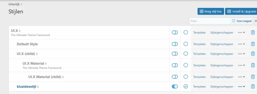

Ok, im a little confused. I ve bought and installed the ui x theme. After i did that i created a childtheme named klusideestijl and made that the default style.

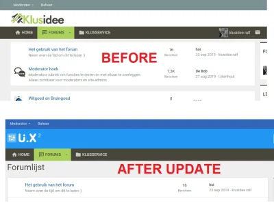

Xenforo came with the announcement that there was a style update for the x ui theme. I started to update that with the idea that it only would change code in the x ui style and not in my childtheme.
After the update my header changed.
I think i miss something here :) Can someone tell me what im missing here.

Hi Imno007,
Ok I will. I was asking it here because maybe i just dont understand how to work with child styles / or made a mistake with the setup as shown in the attachment.

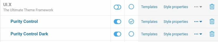

Something is a bit odd with that setup, I think. You have 3 child styles not in use and your current theme is a child of a child? I also have uix and updates don't affect the customizations, usually. See my setup in the pic below. I have two child themes right under the parent framework and one of them is also the default theme:
