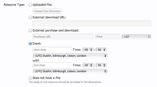

I must be doing something wrong. I made a category to be an event category but I don't see anything other than a normal resource. Nothing about dates and all that.
Screen shots of what. The forms are the exaxt same as a regular resource There is noting in there about event dates ans such.

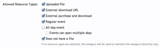

Have you enabled events in "Allowed Resource Types"? It works for me on XenForo 1.2.4 and XenForo Resource Manager 1.1.1.
Ok here is the problem. It does not work if you want it to be an event only category and uncheck the normal file options. To me that's a bug. If you uncheck the top three it doesn't function.
I did a test event and some users had to be told where to go and RSVP when entering via the thread. I suggest having an RSVP tab for those that haven't declared their intention.
It does work however in you uncheck the top three and also uncheck the "does not have a file" option as well.
