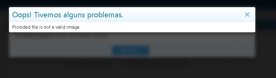

I am trying to make a new campaing and trying to upload the same image that I used before. But the addon isnt accepting my png images.
Maybe its a bug. I dont know. The image is the same that I used every month. I tried with jpg and the same error is displayed.

For Icon I tried both jpg and png files. Is strange because is not a permission report, but a "invalid" error.
I tried images 64x64, 32x32, 200x200, 3384x3585... So is not a resolution problem too.

Seems to work okay for me:
There's two places it will return that error, one if the filesize or getimagesize functions return false, and one if it's not an allowed file type. Shouldn't be the file type as it's a .png so seems to be the first error. Probably suggests the file upload hasn't been saved to disk properly. Can you upload images elsewhere? Avatars, attachments etc?

Not sure then to be honest without debugging directly on the server itself, as it seems like PHP isn't seeing the upload as a valid image which we can't really do much about, but not sure why it would suddenly have started failing or why other uploads work.

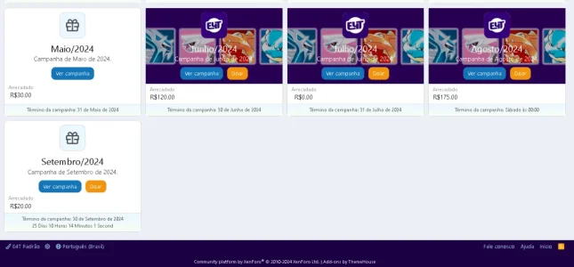

I was creating campaigns because I want to hold a historic of comments and values donated on the month like this.
I dont know if recurring campaign delete data from previous month. If not, I can start to use this function too. I feel like as time goes on this list of campaigns will end up getting really big.

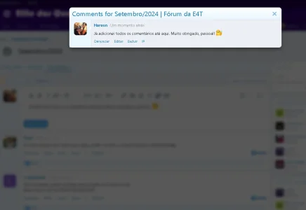

When someone makes a comment in the Comments tab, the page does not reload to show the posted comment.
Instead, only the highlighted comment appears, but without any reaction from the page.
This leads people to think that the comment was not posted, causing people to post the same comment 2x, 3x, 5x, flooding, until they realize that all the comments were entering the system.
The plugin should post the comment as it did before. I remember that in the beginning when I used it, before the most recent updates, the comments worked normally.
Nowadays, users who comment flood a lot, and then they keep deleting the comments, causing many "deleted comments" to appear for me in the history.1726533700249.webp

I literally have the same issue. No idea why this is acting so strange. Everything else works perfectly.
Dunno if this is helpful:
    "status": "error",
    "errors": [
        "Provided file is not a valid image."

Edit: turned off image optimization and was able to upload the images.
