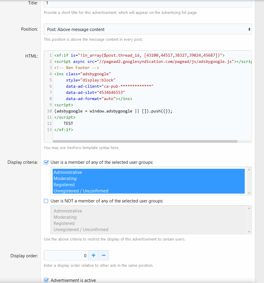

Yea, there is a field "HTML", you can use XF template syntax there. I'm assuming you're showing your ad within a post, so that should work. Otherwise, please post your ad config.
<xf:if is="!in_array($post.thread_id, [43100,44517,38327,39024,45687])">

This is the code I am using, I put in the TEST after the google code just to be sure that I don't see it on the threads that correspond to the array...
But its still showing the TEST and the advert, I also tried $thread
Thank you.
Mick
Did you set it up like this?
There is no position "footer" for me. Are you using some kind of addon which adds additional positions? Otherwise, please just screenshot the Position: line. Or try this one:

It was this area:
Container breadcrumb (bottom): Above
Inside the page container, directly above the bottom breadcrumb on every page.
And thank you very much!!!
The condition worked a treat, now I can action any URLS that Adsense have an issue with and block them...
