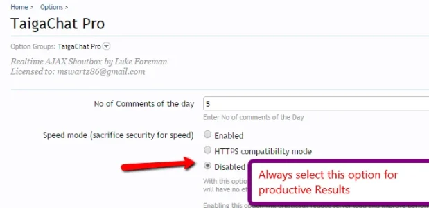

3- No need to uninstall taigachat for its working now. Just select disable option from taigachat options before or after installation of this heart extension.- See attached screenshot. "
So it appears you have to delete all previous templates before reinstalling this, you can't just do a direct upgrade like I did. Also you need to disable speed mode during install.
