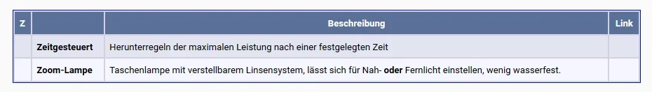

Hello,
we actually use an old vBulletin table addon which we customize for XenForo 1.5x, which came from vBulletin 3.8x, please look here for the original vB Version => "BB Code"
by StGaensler, see here the vBulletin source https://www.vbulletin.org/forum/showthread.php?t=107985
Please have a look at the table code in a sample posting and find the resulting table image in the attachment =>
[table="head;width=100%"]Z | | Beschreibung| Link
|Zeitgesteuert |Herunterregeln der maximalen Leistung nach einer festgelegten Zeit |
|Zoom-Lampe |Taschenlampe mit verstellbarem Linsensystem, lässt sich für Nah- oder Fernlicht einstellen, wenig wasserfest. |
[/table]
We are a technical forum and have lots of tables. We are looking for a useful table addon, but it would helpful if it could use the old table codes too. Or perhaps two addons, one for the old existing tables and one for future tables.
