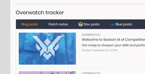

I'm initializing two tab scrollers, and the second one isn't reacting to touch.
Would anyone know why? Thank you.
Edit: I should clarify, I can't scroll with my fingers on the second tab scroller, but I can touch the arrow buttons.
