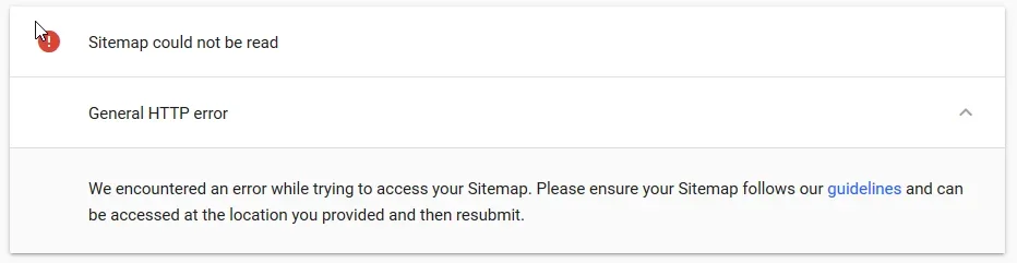

With the new Google Search Console, more information are displayed about the errors encountered.
What used to look like this:
Now looks like this:
The sitemap was not pending, but failing because of an "HTTP General Error".

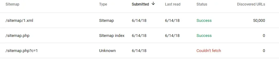

Yet you can browse this partial sitemap at https://forum.cheat-gam3.com/sitemap.php?c=1 or https://forum.cheat-gam3.com/sitemap/1.xml
Now let's do an experiment and rewrite /sitemap/n.xml to sitemap.php?c=n1528997491496.webp
Works like a charm. Yet the headers and body of the HTTP Response are exactly the same:

You need to enable "Full friendly URLs" to remove the query string parameters. We automatically rewrite the sitemap URLs in that case.
You can see the effect this has if you browse to:
https://xenforo.com/community/sitemap.xml
They aren't rewritten by us manually on the server, the software does this when friendly URLs are enabled.
Right now, I am not using friendly URLs. I'll change that as soon as possible. Thanks for pointing out that the "fix" from XF1 was implemented in XF2.
