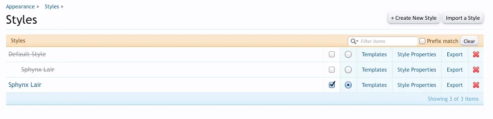

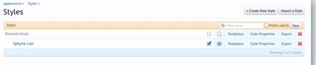

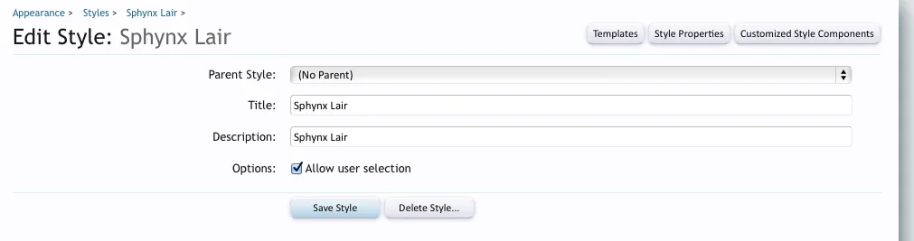

Just so no one will be left hanging if they run into a similar situation and install a third party style incorrectly, I will share what I did to correct it. I just exported both default style and custom style to be safe, chose option "Export as independent style" then just reimport that XML you just imported with NO PARENT. One thing I will mention is my default master style had a handful of edits that I just reverted the templates before hand.
