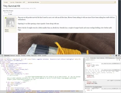

Not sure how best to track this down.
The issue only occurs in this child style of Whisper2 so it must be something I've customized and is related only to guest view. I've tried the obvious and disabled other addons one by one with no change.
The addon is Rate Threads with Stars but I don't believe its the addon's fault. I'm 99.9% certain the issue is caused by me :)
How should I best hunt this problem down?
Thanks!

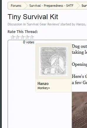

Guest view - avatar bumped over:

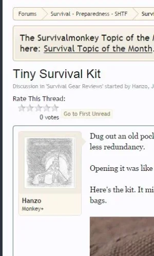

Logged in:

The problem is the rating div for the add-on is floated left and without the page nav, it pushes down into the main section div.
If you clear the section div (I've added clear: left), it resolves it.
