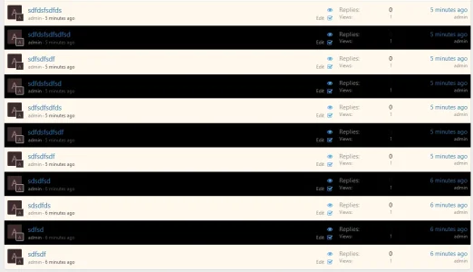

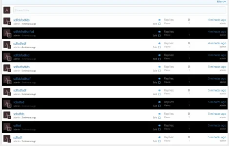

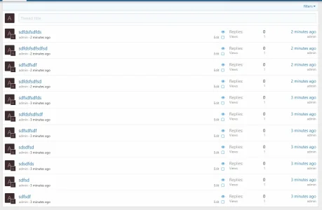

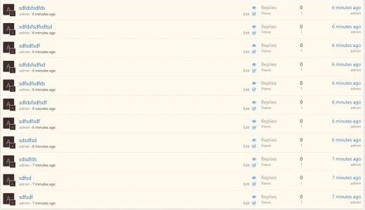

One problem.
When thread moderation tool is selected (the tickbox), and then you select threads in the thread list to moderate, the highlighted color doesn't work for "2n" threads. How to solve that issue?
Normal:
Normal with moderation bar (all selected):
Striped:
Striped with moderation bar (all selected):
As you see the highlight of the moderation selection gets overridden by this. There is no highlight for the 2n-threads.

.structItem--thread:nth-child(2n):not(.is-mod-selected)
Thank you again, much appreciated. Learned sth. new again.
