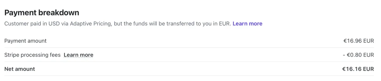

I have also had Adaptive Pricing enabled on my account, and I can confirm it works fine with no changes to the XenForo Stripe integration.
Proof:
The Payment Provider Log in XenForo also correctly shows the payment was verified by XenForo. Relevant section:
Proof:

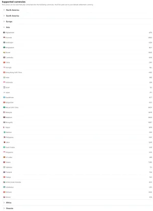

Interesting, I will double check that then. Because I enabled Korean payment methods and the Koreans saying they cannot use them. Screenshots of them showing there is no adaptive pricing option for them and without it, the Korean payment methods cannot work, which is stated in the documentation of it on Stripe.
By any chance you had payments with adaptive pricing on other currency then USD?
I have it enabled since a while now and I cannot find a single adaptive pricing payment, they are all done in EUR directly. But I will dig deeper.
Ok, I found the issue now pretty quick thanks to your message. I was looking at the wrong place and indeed, I have it working also:
Also with else then USD. And the reason Korean payments do not work is Stripe itself, not Xenforo. They offer Korean payment methods, bind them to adaptive pricing, but Korean currency is yet not supported by Stripe itself LOL, not in the list:
